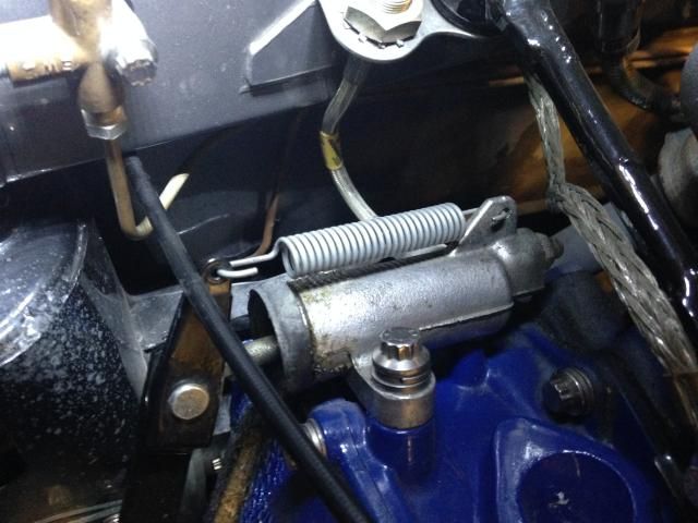

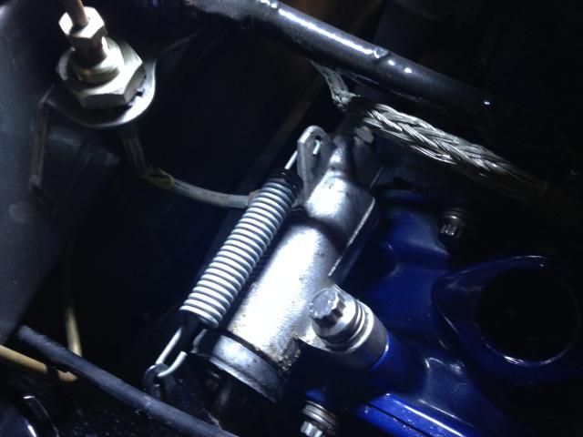

    I need a new clutch slave cylinder. But I'm struggling to figure out exactly which one I have. I was initially thinking I had the Pre-Verto style, but based off the the pictures I've found online they don't seem to match exactly what I have...specifically the return spring tab on top. Can someone PLEASE give me some insight.
    Here's what mine looks like for reference:
    It's certainly a pre-verto, Brian, but I don't think I've ever seen a spring tab quite like that.
      Agree.
      While you are at it, check out the hole in the spring mount on the clutch arm. It appears elongated. Buy a new one, or save a few shekels by removing it and remounting it on the back side of the arm.
        See http://www.minimania.com/msgThread/1...Slave_Cylinder
