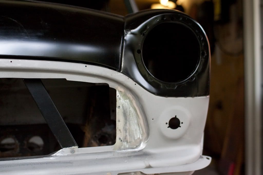

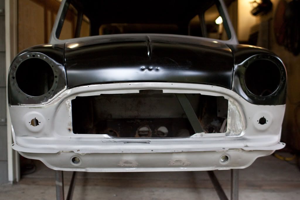

    Well the front end is looking more Australian.

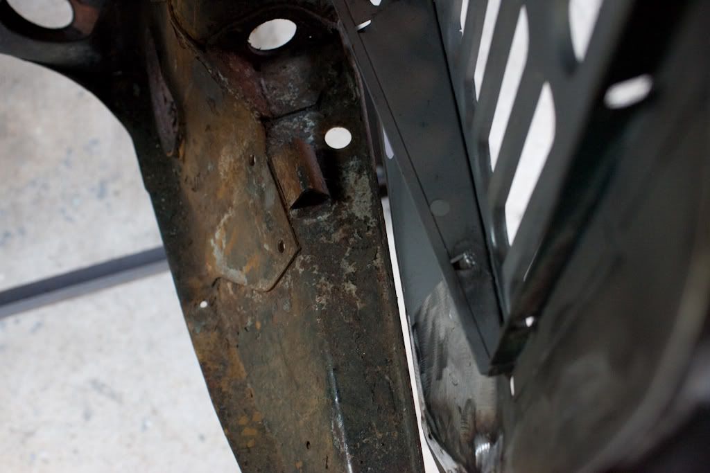

    Vent hole is gone...cross support is spot welded for now, can add rivets later.
    Front subframe gap just right...
    Continued...
